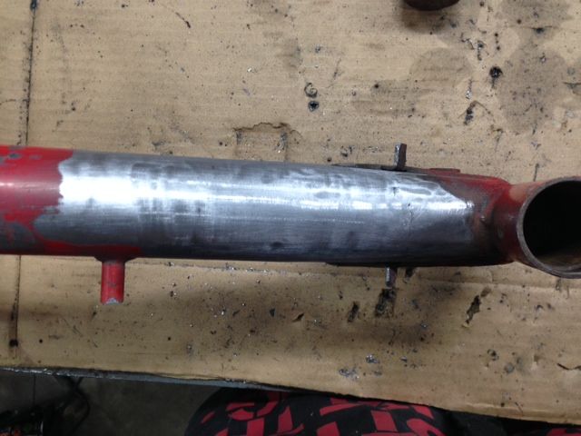

bikes been run into some thing as forks are bent back a bit and kink in frames back bone just behind front gusset.
straight edge shows bend in forks
here some one has attempted to apply heat and oxy weld braize it

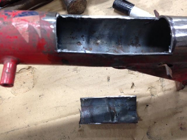

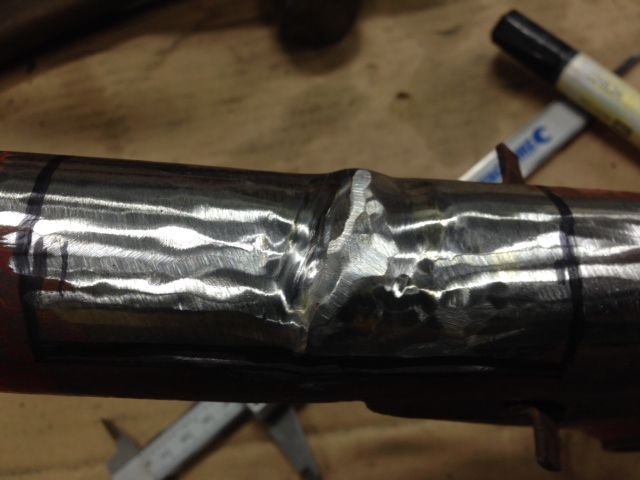

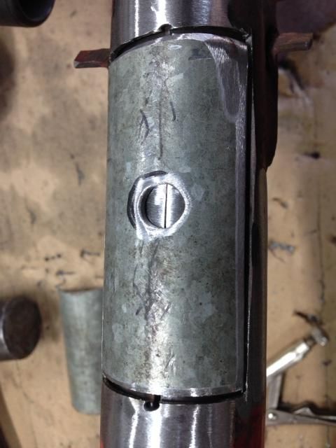

I recently sent 3 Z50M frames off to be repaired,  2 are for me to restore and the 3rd is payment for frame repairs. anyway heres some updates of the  repairs to first M frame.
brass removed on back bone near front tank mount. shows damaged area from front impact.
next pic shows damaged piece cut out
then internal reinforcement piece welded in then piece over top.
finished off nicely.... well done to my friend from Sydney Blackattact for the repairs.
